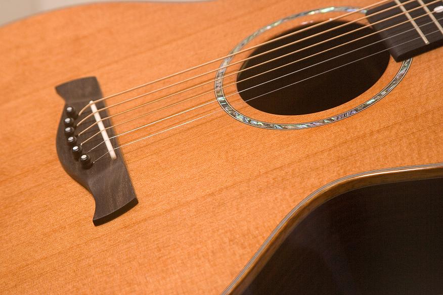

I am about to start the Bling Bling display case guitar for my cousins music store, It will be quilted Sapele back and sides, I am thinking Snakewood for the binding. He wants bwb-green abalone-bwb purfling on top, back, sides, fretboard, peghead and rosette. The only thing really up in the air is what top to use. After seeing Lances LS Redwood I am leaning to Redwood to kep the redish amber hues going, however my cousin fell in love with the Sitka bearclaw on the OM I did to replace the Ovation I burned up.
Ok everyone pipe-up and give me your opinions. This one is going to be gaudy in my book but that is what he wants

I think that the combo of Green Abalone and a redwood top is gorgeous! Id vote for redwood. IF you were inlaying Red abalone I think a spruce top would be nice.
PostPosted: Fri Aug 26, 2005 3:25 am
Red abalone actually looks better with redwood. Green ab and redwood looks like a Christmas guitar...

Ok lance, Who did you get your redwood from?
PostPosted: Fri Aug 26, 2005 4:05 am
That set came from Hank Mauel - about 2 years ago when he helped Alicia Carter clear out her late husbands stock.
PostPosted: Fri Aug 26, 2005 4:11 am
Pretty set! nice silking

You can't ask Lance's opinion on what top to use...he will always say "redwood"! He doesn't build with anything else!
